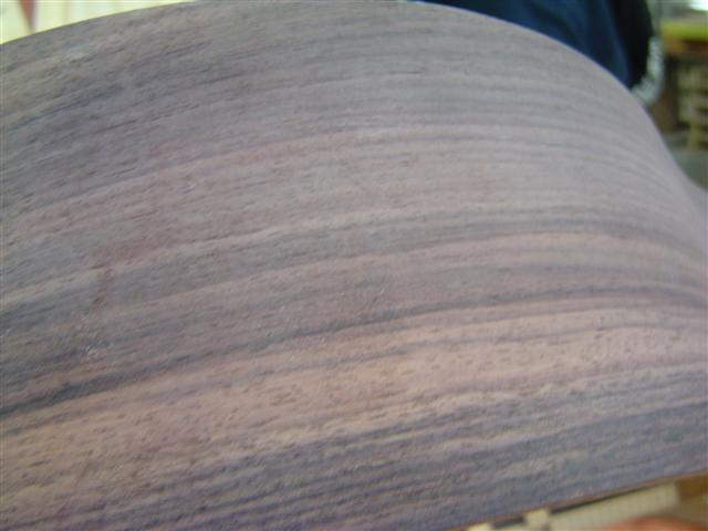

You know you are having a bad day when this happens!
This is one of my student's guitars and the thing is just fighting him from start to finish!
I will post pics later of the repair.

Robbie,
That must have been awful for your student! What brought it on?
PostPosted: Mon Mar 06, 2006 8:39 am
Posts: 2353
we noticed a small crack at the waist when we were ready to glue up the top and back. The glue up was put on hold and then as we were trying to remove it from the form to repair the small crack the stress was increased or released and it just did what it wanted to do. It is a clean break with the grain so it should repair nicely but it sure gets your attention.

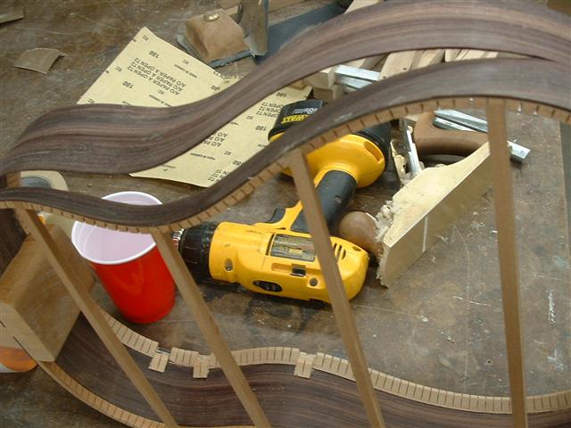

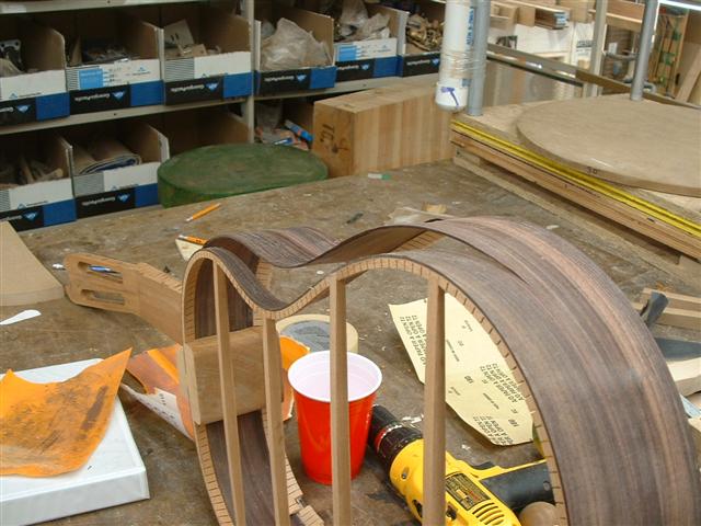

Umm...what's with the back braces attached without the back????? Now that just doesn't look right!

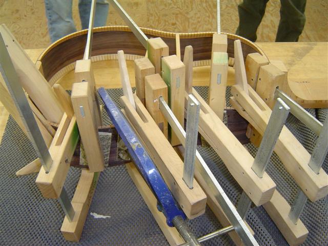

I will try and remember to get some more pics of it. We have already glued it back together but I haven't got a pic of that. Maybe I could just explain it. We used fish glue on the cracked area. CA glue tends to leave a white line if accelerator is used. Since this was quite a large break I decided that either hide or fish glue would make it less visible when all is said and done. I just happened to have the fish glue handy so that is what I used. I made several small clamping blocks and put one on the inside of the guitar side and one on the outside of the guitar side and then used a cam clamp to align the crack. I did this in several areas all the way along the cracked side. I then used cam clamps on the top and bottom of the side to close the cracked area. It seemed to work pretty well. In the areas in between the clamps my student installed a few side braces. This whole mouse trap is up at the school. I will try and remember to take some pics of it clamped up before we remove the clamps. After a little sanding and scraping it should be as good as new again.

on my classical guitars I install the back braces into the kerfing by 6mm. so they are actually below the binding line and do not go through the sides but just up to them. I do the opposite on my steel string guitars.

[QUOTE=Don Williams] Umm...what's with the back braces attached without the back????? Now that just doesn't look right!
Yeah looks a bit unorthodox... but Torres at one stage built up his sides and top and then fitted the back braces before fitting the back.
See Courtnall's book "Making master Guitars" for details.
Cheers Martin
PostPosted: Mon Mar 06, 2006 10:27 pm
Posts: 1055
[QUOTE=Robbie O'Brien] on my classical guitars I install the back braces into the kerfing by 6mm. so they are actually below the binding line and do not go through the sides but just up to them. I do the opposite on my steel string guitars. [/QUOTE]
I do this for both all my guitars. Some references recommend cutting through both kering and side to house back braces but for some reason Ive never been comfortable sawing into my sides.
I trim my back braces to circa 4mm. I then remove sections of kerfed lining and glue in sections of new kerfed lining offset to accomodate back brace ends.
Cheers Martin

I said I would post pics of the repair for the sides cracking.
This shows how we clamped the sides together to align them and close the crack.

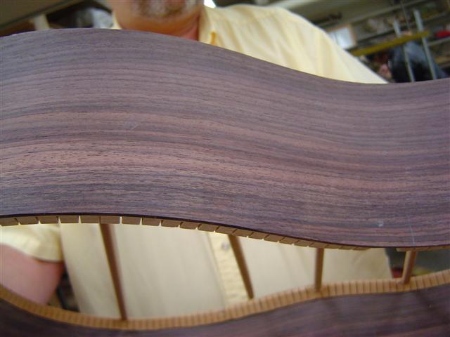

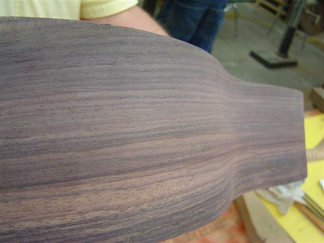

Here are the shots after removing the clamps and cleaning up the side with a scraper and sandpaper.
good as new!
